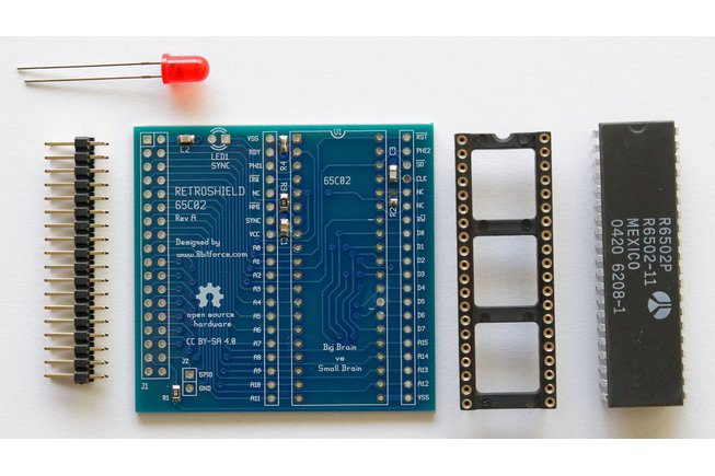

Do you know what would be perfect? This:
https://www.tindie.com/products/8bitforce/retroshield-6502-for-arduino-mega-2/
For the 65c02. This an example of something I would be interested in making. Minus the chip, because I have my own stash of those :D

In any case, attaching a CPU (6502, et al) to something like an Arduino in the method shown is more like putting the CPU on life support, albeit very slowly. Depending on what your goals are, this could be perfectly acceptable. However, keep in mind that any and all software running at a sub-megahertz speed is going to result in a lot of watching and waiting.
Gordon (drogon on the forum) has implemented both 65C02 and 65C816 SBCs that use an ATmega (IIRC) to front end the processor cold start. load RAM, then release the processor to start and then use the ATmega for console I/O and more. It's an elegant solution... and allows the processor to run at high speeds, ~16MHz.
Bill (plasmo on the forum) has also implemented many different CPUs with CPLDs to manage the process and provide the Glue logic and some I/O. Again, elegant solutions.. and provide for a high speed CPU clock rates, as the intended CPU is "running the show".
https://www.tindie.com/products/8bitfor ... no-mega-2/
You likely won't learn much assembling something like that and as flooby notes, you'd not be getting the essence of what 6502 computing is all about.

Don't misunderstand - I've already had the experience of building a couple of breadboard computers using 65xx chips, made a little monitor using xmodem to load programs into RAM, etc. I'm just trying to cut down on the wires, and the problems that come with them. And, no, I'm not running a 65c02 with an arduino, either :wink: It's the form-factor. I want to be able to have, like, a modular design that doesn't require an afro-full of wires each time I want to make a change. Plus, pmod boards with chip sockets would be great with xilinx boards.

Okay, so I guess I'm still not grasping exactly what you're trying to do or accomplish with the 6502. You linked the Tindie shield stating it would be perfect, which shows it attached to an Arduino... and my response was specific to what you linked to. So perhaps you didn't fully explain what it is you liked about the shield and how you plan to use it?
I also prefer to avoid extreme prototyping... get enough bits and pieces working, then create the final schematic and make a PCB to implement. It's pretty easy these days, compared to the 70's! Also, I'm not 100% certain on what you reference as a "pmod board". Digilent has their own specification and a large offering of boards for this. It might be useful to provide more detail on what you think you want to make as a CPU pmod board and what you're going to connect it to as well as what you expect it to do and the benefit from it. I'm just suggesting here.... and... might as well start a new thread on this, as this has strayed quite a bit.

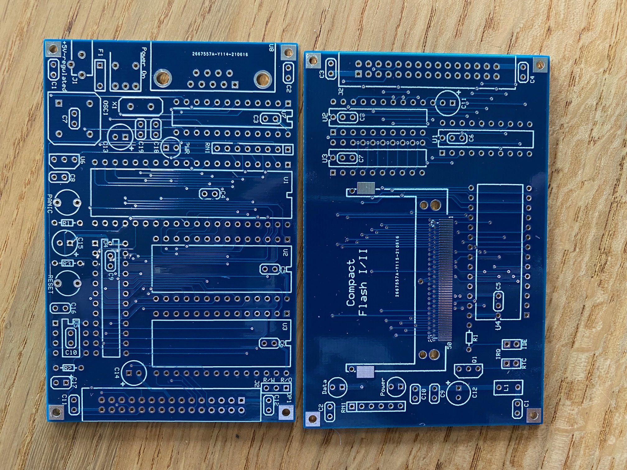

Hello All,
Today the PCB's arrived!
They look good!

That they do.

Yes, the PCBs do look quite nice (in blue). PM me... I'll send you a utility program that you can load to setup the RTC and format the Compact Flash drive so you can use it with DOS/65. Granted, it's not quite at a 1.00 version, but it certainly helps in sorting out the RTC setup and getting the CF Card accessible from DOS/65.
Note: DOS/65 doesn't do anything with the RTC... at least not yet. I'm hoping that Richard Leary will eventually provide support for the RTC, time will tell.
