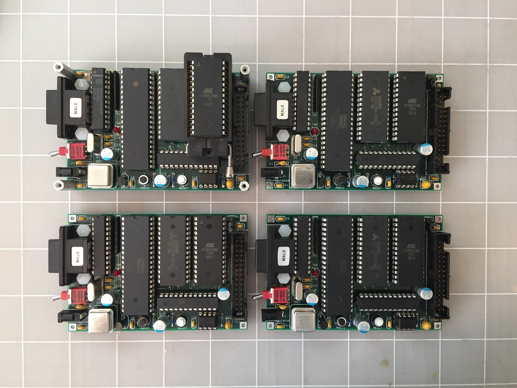

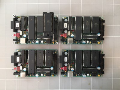

I've also built up multiple boards every time I design a new one. In general, I usually end up doing a second revision of every board, as I always end up with something that was either wrong, didn't like, or changed my mind. Here's a pic of four of my C02 Pocket SBCs. I ran 3 boards 24/7 for almost 3 years. The 4th board (ZIF socket) was my active development board. Once I make an update, I re-program the EEPROM on the other three and continue long term testing.
My Monitor code has a macro facility... so I can stack multiple commands and then have it loop endlessly for testing. It is limited to 127 bytes, but you can fit a fair amount of commands, etc., in 127 bytes. I also coded a 16-bit loop counter which is an option for the macro facility.
I like the board you've done... looks really good. Have your thought about trying a standard 2.5-inch IDE drive (also 44-pin connector) with the board? I have a bunch of smaller capacity drives, so I'll likely start using some of those in the near future.

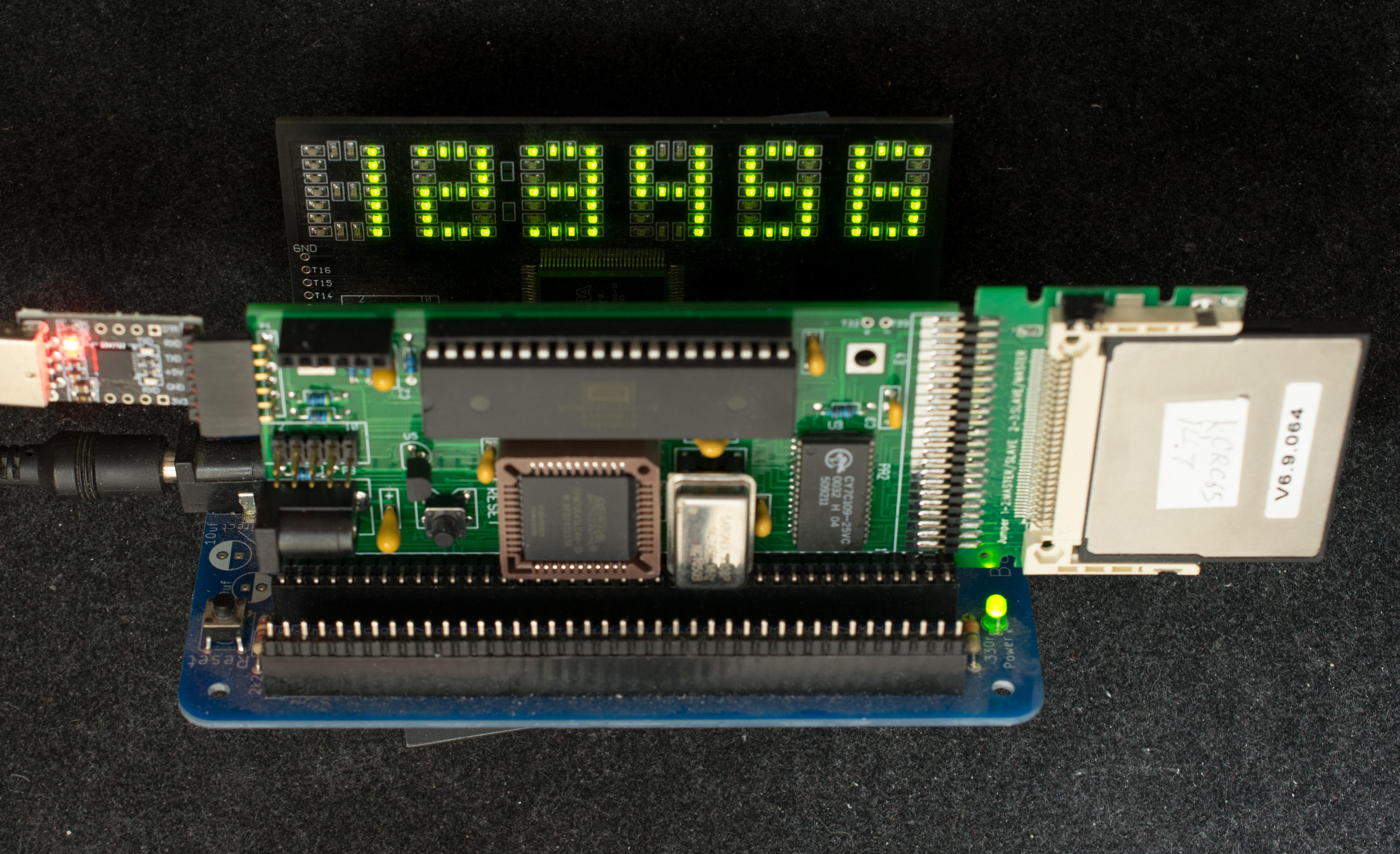

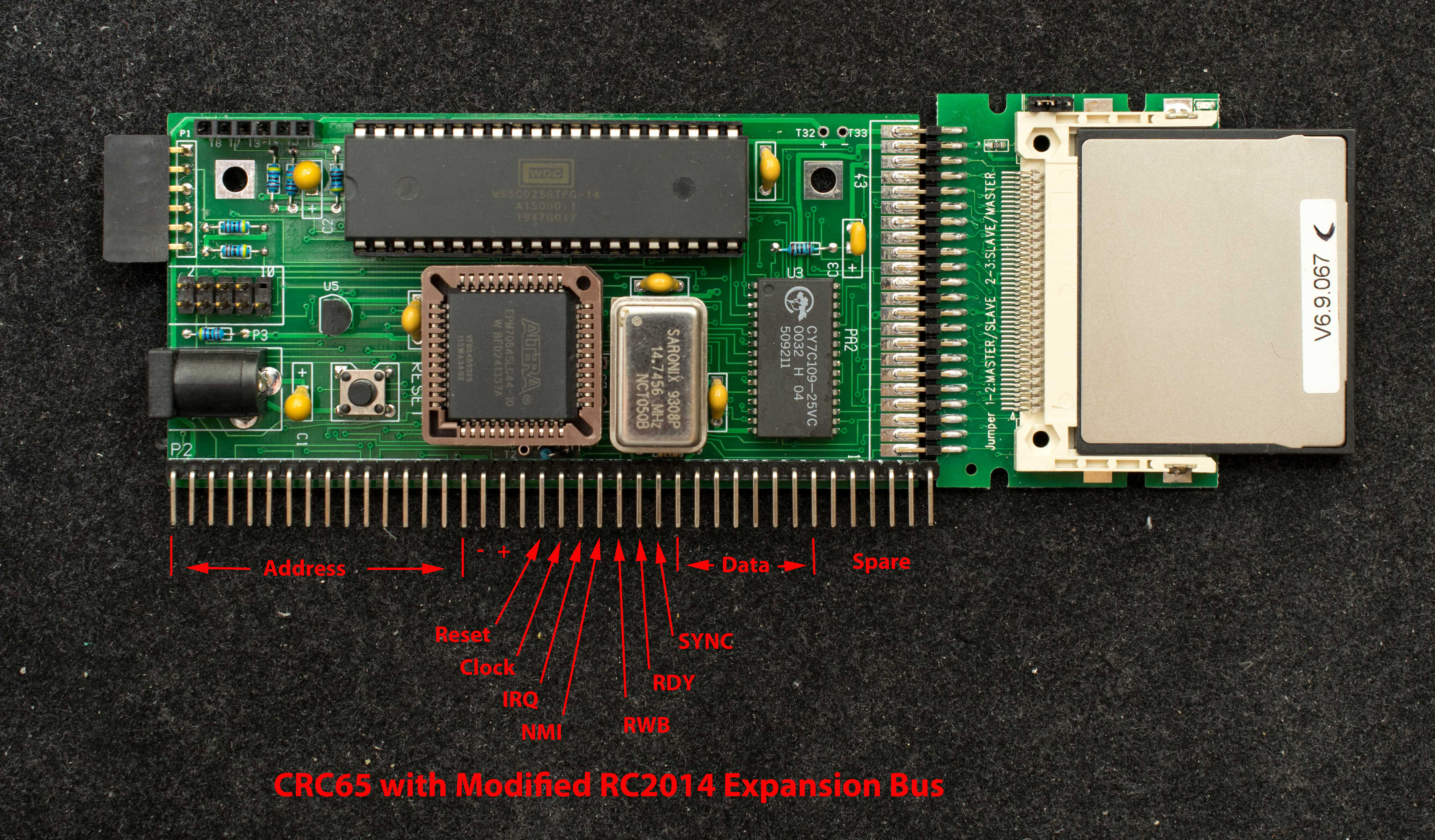

CRC65 has a modified RC2014 expansion bus; it is a single-row of 39-pin right-angle male connector. The pin assignment for address, data, power are the same as RC2014. Many of the controls signals are also the same. The few different signals are 6502 specific. See photo 1 for signal assignments.
For RC2014 boards that use CPLD for decoding, it is easy to change the CPLD equations to accommodate CRC65. Photo 2 shows CRC65 plugs into a RC2014 backplane driving a CPLDTIL display board. Similarly the existing RC2014 prototype boards and VGA video board also can be modified for CRC65.

File comment: Signal assignments of CRC65 expansion bus
File comment: CRC65 (foreground) on RC2014 backplane driving a CPLDTIL (background) display board.

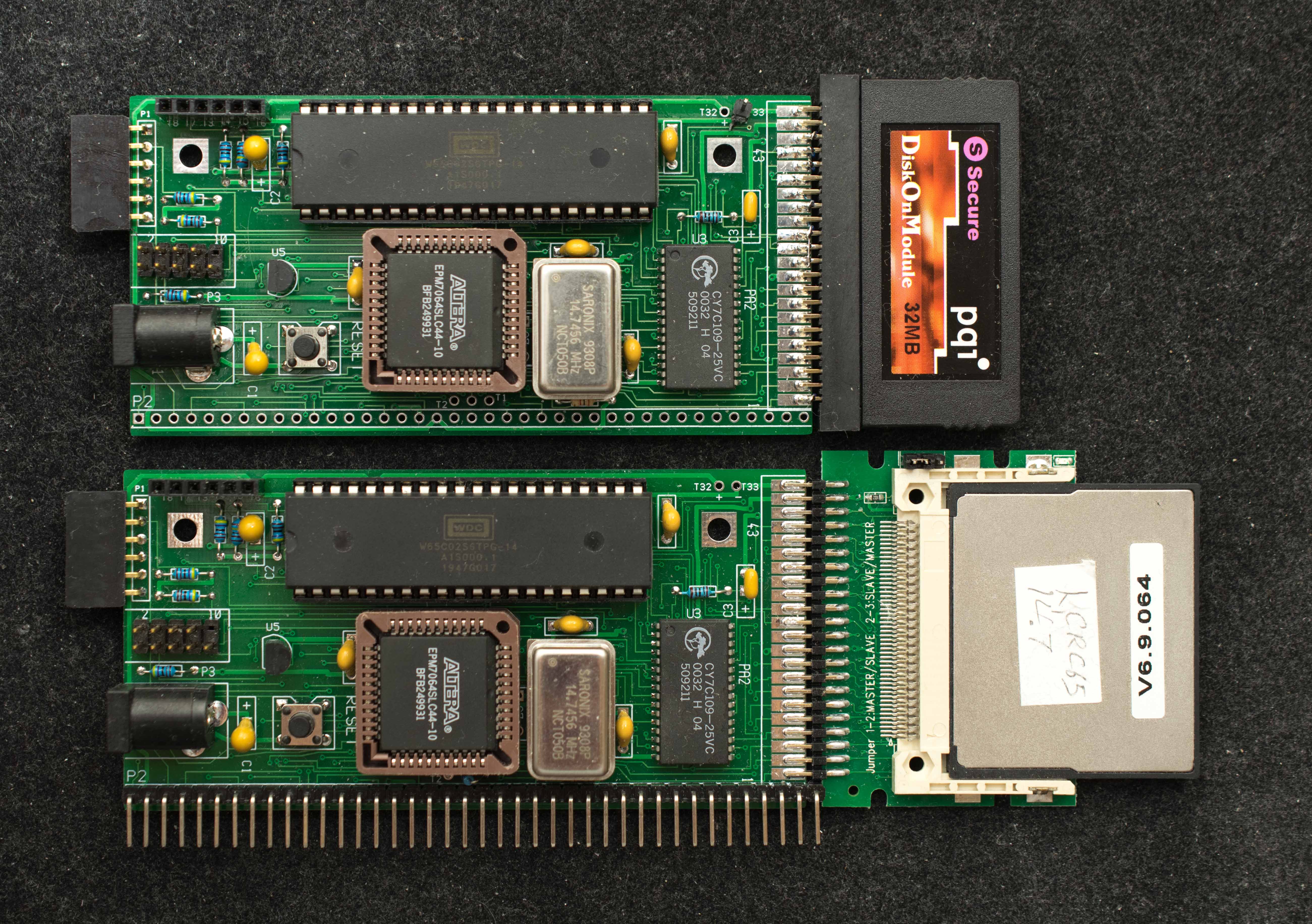

I have a number of salvaged disk-on-module (DOM) that are too small (32MB) to be useful. However, in this case, 32MB is the whole world of 6502 software. Like CF interface, DOM interface is also a 44-pin, dual-row 2mm connector, but the pin assignments are mirrored. So some manual wiring are required to flip the top & bottom connections. With these modifications, the DOM works nicely. It is also more compact than CF disk as shown in the side-by-side photo.
