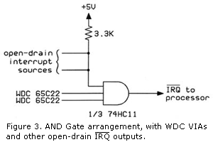

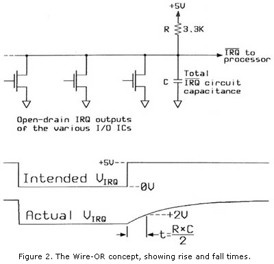

Now I must mention a hardware consideration here. The ISR above first tells the VIA that it can quit asserting the interrupt. There's a reason for doing this first. Most of the 65-family I/O ICs have open-drain IRQ outputs, intended to be connected to each other and to the processor's IRQ input. Any of the I/O ICs can pull the line low, but the only way it will go up is with a pull-up resistor pulling the line up to the positive power supply voltage. The recommended resistor value is usually 3K. Well, since the IRQ line has some amount of capacitance to ground and other nets, that capacitance multiplied by the pull-up resistor value gives you a time constant. If you put the IRQ-clearing instruction(s) at the end of the ISR, it's possible that there won't be enough time for the resistor to charge that capacitance up to a valid logic-high state before the RTI is done executing. The result will be that as soon as the ISR is done and the old status register flags are restored with the interrupt-disable bit clear once again, the processor is again open to handle another interrupt, so it will respond to the still-low IRQ line because the IRQ has not had enough time to float back up. Remember the rise time with the resistor is much slower than totem-pole-type logic outputs. If you only have one interrupt source on the IRQ line, a 3K pull-up resistor, and only 1MHz clock speed, you can normally get away with clearing the interrupt near the end so you don't need to worry about it; but turn up the clock speed and put more IRQ sources on the line, etc., and you can get into trouble. I mention it because I've been bit by it.
While most 65-family I/O ICs have open-drain IRQ outputs, WDC's 65C22 VIA (Versatile Interface Adapter) does not. That means that to feed more than one WDC 65C22's IRQ output into the processor's IRQ input, you'll need an AND gate arrangement, so that if any one of the IRQ's goes low, the processor's IRQ input is taken low. The AND gate may make for more parts, but the faster resulting rise time takes care of the potential problem mentioned above, especially with their faster processor speeds of 10MHz and higher.

Most interrupt sources will be connected through the processor's IRQ input. It is level-sensitive for a good reason. Suppose an interrupt occurs, and the processor carries out the interrupt sequence and enters the ISR. Now before that particular interrupt is turned off, suppose another interrupt occurs, also holding the IRQ line low. When the servicing of the first interrupt is finished, the IRQ line continues to be held low, so there will be no further edges. Having the IRQ input to be edge-sensitive would not be appropriate. The continued low level on the IRQ line is the only way for the processor to know that there is another interrupt needing service. If the ISR has no CLI instruction and does not check for further interrupts before finishing (as is normal, as discussed earlier), then the interrupt sequence will be carried out again right after the RTI instruction.

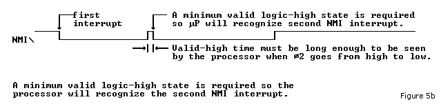

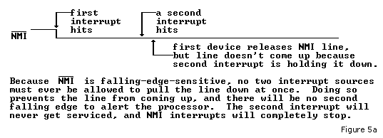

Now back to the 6502's other interrupt input we've hardly mentioned so far, the NMI. This one is not level-sensitive, but edge-sensitive. Since it is not maskable, making it level-sensitive would have brought about the same endless-interrupt-sequence disaster mentioned earlier. However, the fact that it is edge-sensitive limits it to generally only one interrupt source. If there's more than one, steps will have to be taken to make sure that no two sources can pull it down at once, or at least that there is no way that one source can get unnoticed by the ISR and be left unserviced, thereby holding the NMI line low such that no more edges can occur. See Figure 5a.
Furthermore, you need to make sure that some minimum amount of time between low states be observed so that the processor has time to see that the NMI voltage actually went up and back down. The NMI line must be at a valid logic high state long enough to be seen by the processor at the time of one φ2 falling edge. It can be low again for the next φ2 falling edge, and the processor will recognize the new interrupt. These φ2 falling edges do not have to be at any particular part of an instruction in progress. See Figure 5b.
Since it is not maskable, an interrupt on NMI can cut in on the servicing of an IRQ interrupt, even thought the interrupt-disable I flag is set. Note also that if an NMI and an IRQ hit at the same time, the NMI has the higher priority and will get serviced first.
We're often told to reserve the NMI for something drastic like power going down; but in most systems the people on 6502.org are making, what happens in the last milliseconds before power is gone is of no concern. If you have a system that remembers things when it's off, it probably has batteries and can turn itself off in an orderly fashion. Otherwise, if you accidentally pull the power cord, there's no time to store anything useful on a disc anyway.

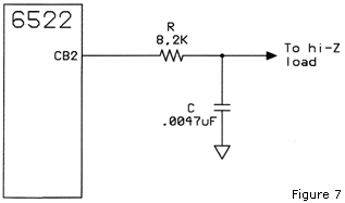

3.3 USING THE 6522'S SERIAL PORT FOR SIMPLE ANALOG OUTPUT
Interestingly, if you can get away with only 9 output voltage levels (which is slightly better than 3-bit resolution), you can do a similar kind of thing with the VIA's serial port in mode 100, shift out free-running at T2 rate. In this mode, the shift register just continues to shift out the last byte you stored in it, over and over, until you give it another value. You only need the CB2 (serial data) line, and not the CB1 (serial clock) line. The idea here is that anywhere from 0 to 8 bits are set, giving you nine levels. Using something like:
00000000 for 0, gives .000V output;
00010000 for 1, gives .625V output;
00100010 for 2, gives 1.250V output;
01010010 for 3, gives 1.875V output;
10101010 for 4, gives 2.500V output;
10101101 for 5, gives 3.125V output;
11011101 for 6, gives 3.750V output;
11101111 for 7, gives 4.375V output; and
11111111 for 8, gives 5.000V output.
Of course, these voltages are ideal for the 65C22 (CMOS). The 6522 (NMOS) voltages will differ. Non-ideal conditions will not contribute significantly to distortion since the proportions are left intact, but the amplitude of the output signal may be reduced slightly.
Staggering the bits as much as possible as shown above facilitates filtering so you can get the smoothest possible analog output waveform with just a first-order RC output filter. This D/A method is adequate for generating DTMF (dual-tone multiple-frequency signals for telephone dialing), as well as other low-resolution signals. It will do much better at intelligible speech than many toys which use only two bits and slow sample rates. To make it easiest to filter, set the T2 latches for 0 so you get the maximum shift rate. T1 can still be used to control the rate at which the sample value is updated. Your RC output filter might be configured like that in Figure 7.
Figure 7. Simplest 6522 serial port D/A converter output filter, with -3dB point at 4kHz.

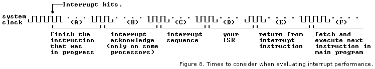

APPENDIX A. INTERRUPT PERFORMANCE
Figure 8 shows all the various times that should be considered when evaluating overall interrupt performance. (Some processors' sequence of events may vary from the diagram.) Interrupt latency is generally the amount of time it takes for the processor to begin the ISR after the interrupt line goes true. Sometimes this is measured in terms of the interrupt sequence only, which is 7 clocks for the 6502. The interrupt sequence is depicted in Figure 8(C). (The single-clock latency trick is still coming.)
Just as often however, interrupt latency includes more than just the sequence. It may also include the amount of time to finish up an already-started machine-language instruction before the interrupt sequence can begin, as depicted in Figure 8(A), and additionally on some processors, the time to do a separate interrupt-acknowledge step as depicted in Figure 8(B). The 6502's simpler method does not require this interrupt-acknowledge step or the associated extra hardware.
The longest-executing 6502 instructions (indexed read-modify-write instructions where the indexing causes a page boundary to be crossed) take 7 clocks. The average is about 4 clocks, depending on what you're doing. It is logical to assume that on the average, the interrupt will hit about in the middle of the instruction, making it necessary to complete about two more φ2 cycles before the interrupt sequence can begin. This gives an average total latency of about 9 clocks for the 6502.
The logic levels of the 6502's interrupt input pins are sampled on the falling edge of φ2. The falling edge of IRQ or NMI can be near the end of the last φ2-high portion of the last cycle of a machine-language instruction, and the interrupt sequence will still begin before φ2 rises again. With instructions as long as 7 clocks, this means the total latency can be anywhere from slightly over 7 clocks (the time taken for the interrupt sequence itself) to slightly over 14 (the time for the interrupt sequence plus the longest-executing instruction). I say "slightly over" because the interrupt input must fall at least 10 to 200 nanoseconds (depending on the speed rating of the processor) before φ2 falls in order to be detected for that cycle. If the interrupt input falls too late, it will not be detected until the next cycle. If that next cycle starts another instruction, then that instruction will have to be finished before the interrupt sequence will begin.
