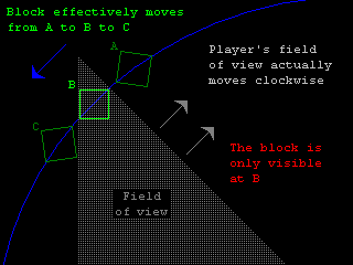

Sometimes while turning, blocks will flash into view at the edge of the monitor but then disappear as they move towards the centre of the view. This is because the field of view is terminated by a straight line at a fixed distance in front of the player, which is quicker to calculate, and not a radial distance. See the image to the right.

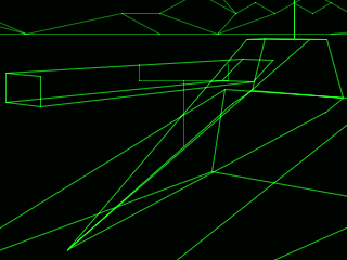

Bent bitsOne curious thing I've noticed is that the super tank is missing a vertex, the top left edge of the gun barrel has gone awol!
Normally you would never see this as the top edge of the super tank's gun is at the player's eyesight level, so this edge would be behind or in front of the other barrel edges. However when you collide with something the viewpoint is shifted upward briefly to simulate the shock of the collision, when you collide with a super tank you can see where the vertex should be but isn't.
I'm not sure why this was done, not to save space as it only saves a couple of bytes, but I think the top edge of the super tank's gun barrel would look a bit too bright otherwise. If my curiosity ever gets the better of me I'll fix the missing vertex and try it out on one of my machines.

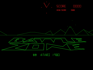

One one of the attract screens the game logo drifts gracefully up the screen and off into the distance. What you never notice, because it can't be seen from the usual angle, is that the A in BATTLE is bent out of shape. If you modify the game so you can wander about the world as you will however, you can see the logo from some unexpected angles.
