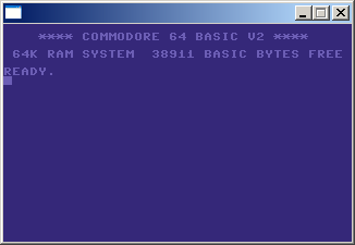

What's been changed since.You would expect that as things were fixed the code would work better and better. What really happened was that it would almost work then I'd fix another thing and be left staring at a blank screen - again.
Eventually it all came right and I got the familiar C64 sign on screen but not until after having to write test ROM images and adding some debug code, which is still there, so I could tell which opcodes were failing and how.
