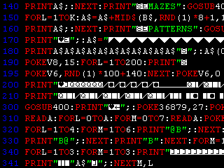

After the text output prompt you will be asked if you want an html output file. If you answer yes, or just press return, an html file with the same name as the input file but with an .htm extension will be output. As well as this you will be asked if you want html graphics, if you answer yes to this then the special Commodore characters will be rendered as 8 by 8 graphics instead of as ASCII names, e.g.[CTRL] 1, which is the colour control for black, will be replaced by "
". An example of this type of output is here where the {CLR} on line 11 has been replaced by it's graphic equivalent. The default response is not to use graphics.
3 PRINT "VIC 20: GREAT GRAPHIC ABILITY"; 10 V=INT(7*RND(0)) 11 PRINT"
":POKE7680+K,102 12 POKE38400+K,V 13 IFK<24THENK=253 14 IFK>483THENK=253 15 POKEA,E:POKEB,D:GOTO 3
