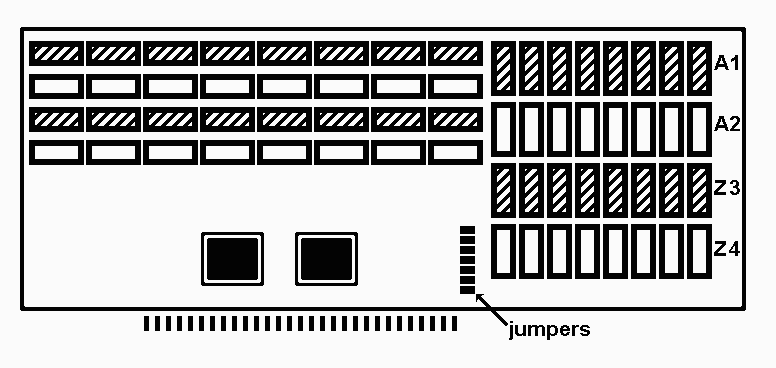

The 8-UP! RAM card for the Amiga 2000 is zero-wait state, autoconfiguring "fastRAM" memory peripheral capable of supporting as little as 2 megabytes or as much as 8 megabytes of DRAM (Dynamic Random Access Memory). 8-UP! uses 1 megabyte by 1, 150 ns or better, DIP RAM (standard RAM chips).HOW TO FILL UP YOUR 8-UP!Since 8-UP! is organized into two separate "PICs" (Amiga-speak for individual peripheral cards), you can install 2 or 4 megabytes of memory in each PlC and have a total of 2, 4, 6, or 8 megabytes installed. The 6 megabyte installation is important to users who have the Commodore Bridgeboard installed since that "steals" 2 megabytes of autoconfiguration space. We've named the PICs on 8-UP! with the arbitrary designations "A" and "Z". Look at your board and you will see the code letters A or Z written on the printed circuit board, to the right of each bank of 16 sockets. Notice that each bank of 16 sockets breaks across the entire width of the board from left to right, the first 8 sockets are horizontally oriented; the next 8 are each vertically oriented.
Installing RAM:
Unless you bought your card fully populated with eight megabytes of memory, you should become familiar with the proper installation of RAM on 8-UP!. Always handle RAM chips carefully; by their edges; and with proper attention to the dangers of static damage. RAM chips are "polarized" by the notch, you can see at one end, on the top surface of the chip. This notch is oriented to the "west" (left) in the first eight sockets of a bank, and to the "north" (up) in the next eight sockets of the bank.Order of Installation of RAM:
Closely examine the RAM sockets on 8-UP! and you'll notice a series of silk-screened labels on the right side of the board identifying each each bank of sixteen sockets by its PlC and by its order within the PlC. RAM must be installed in complete banks of sixteen chips and in the following order: A1, A2; then Z3, Z4.
