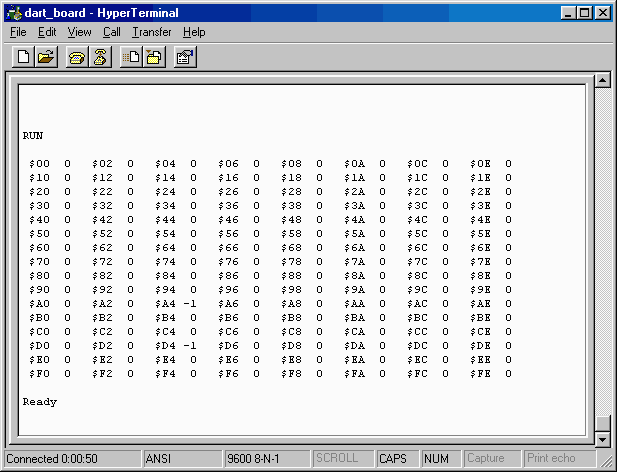

When this code is run it gives an output like that shown below, any addresses that respond with an ack bit return -1, any that don't ack return zero. In this case the only active addresses are $A4 and $D4, both part of the RAMTROM FRAM & RTC chip.
Once the code has been loaded into memory and the USR() vector set you can use the routine to continuously test one address with a simple loop thus ..
DO:A=USR($C2):LOOP.. which is how the stable 'scope displays were made for these pages.
