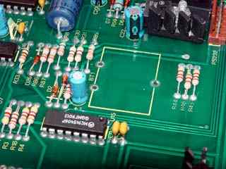

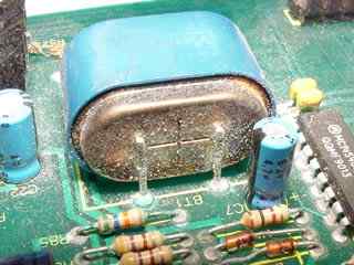

The first thing that should be done is the removal of the NiCad battery. These boards have not been powered for some time and the batteries have suffered. In most cases the cells have leaked and started to corrode the surrounding board. Either unsolder the cells or cut them off but do it now. Once the battery is removed you can clean the area round the battery with either detergent or a non grease solvent (meths, ULS400D etc.) and a stiff brush.

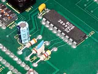

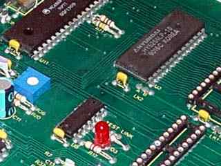

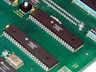

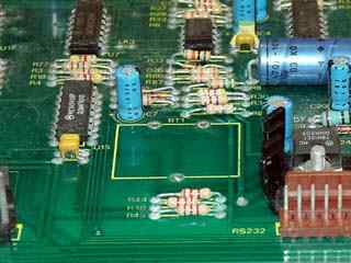

The clean board should now look like this.
Once the board is clean inspect it for broken or missing components. Capacitors, because they are vertically mounted, often get damaged by careless handling. Replpace or resolder any that are suspect or obviously damaged.
