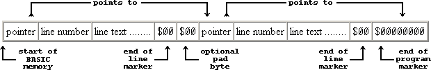

BASIC functions, variables and arrays.A BASIC program is stored in memory as follows ..
The start of memory is held in Smeml which is at RAMBASE+$2E. Each BASIC program line is stored as a longword pointer to the next line, a longword line number, the tokenised line text and an end of line byte. Optionally, if the next byte is at an odd address, there is a null pad byte.
This repeats for each line until the pointer after the last line which is null, this is the end of program marker.
If there is no program in memory only the end marker will be present.
