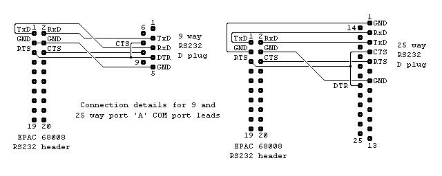

Either of these leads will allow you to connect the EPAC 68008 to a PC COM port using a standard null modem lead. This is for the 'A' serial port on the MC68681. This is the port used by the BIOS as it's default I/O port.

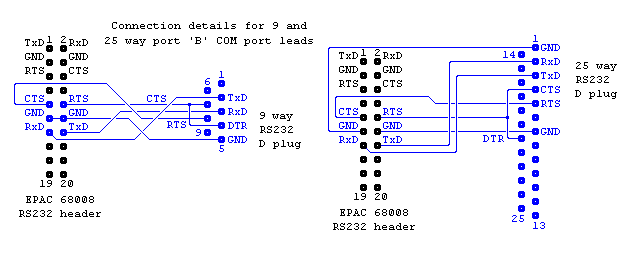

To use the 'B' serial port on the MC68681 a lead like either of those shown below can be used.
