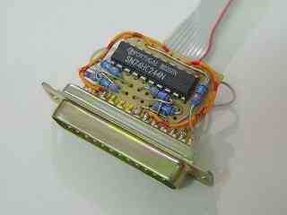

Building it.The simplest way to be able to program the Altera CPLD devices is to make your own Byteblaster cable. The details are available from a number of sources including Altera themselves in their dsbyte.pdf document.
Detail veiws.I originally built this one using a 74LS244 as per the Altera document but changed it to a 74HC244 so I could also use it to program the 8 Bit Baby, as it didn't work with the LS device.

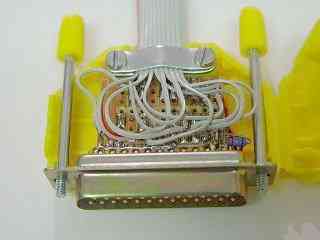

As can be seen below everything was mounted on a small piece of stripboard that was wedged between the pins of the 25 way plug. The resistor leads were left long so that the resistors could lie flat in the plug cover. Though it doesn't look like it there is about 0.05" between bare leads.
The cable and IDC header were 'salvaged' from an old PC.
It's not pretty but it does work. Once it's all safely enclosed the exposed resistor leads are not a problem.
