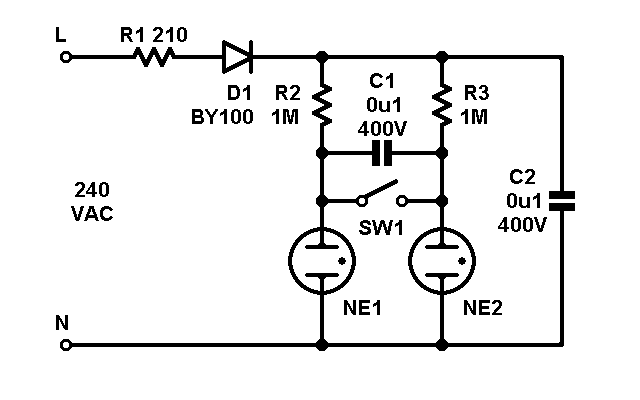

The circuit.This wasn't the first project I ever built but it was the first one that was ever finished completely, case and all. I think I was around ten years old at the time and the fact that it is in a box is probably the only reason it has survived for more than

The circuit is a fairly simple thing. R1 limits the current should it all go horribly wrong, just not enough to make it safe. D1 and C2 form a DC supply of about 380v, far more than this circuit needs to work.
With SW1 open when the circuit is first powered C1 is discharged and one of the neons will strike. This will lower the voltage across both the neons preventing the other neon from striking. As the voltage across the lit neon is fairly constant C1 will begin to charge via the 1M resistor connected to the other neon. Eventually C1 will charge far enough for the other neon to strike and, as C1 is now charged, lower the voltage across the lit neon causing it to extinguish. The process will now repeat but with C1 charging through the other resistor.
When SW1 is closed C1 will be discharged and whichever neon was lit at that point will remain lit. Opening SW1 will allow the circuit to start oscillating again.
I don't think any of the component values are critical, they just need to be able to handle the voltage. C2 can be polarised as it only ever sees DC but C1 must be a non polarised type. R2 and R3 should be the same value and NE1 and NE2 should be the same type. The circuit will work with D1 either way round and the original mains plug was a two pin non polarised type, which I think I later stole for use on something else.
