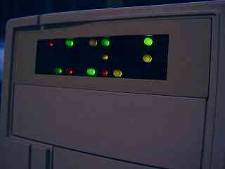

The circuit.I originally built the first one of these quite a few years back when your average PC was a beige box and, if it was expensive, had an LED display showing the processor clock spee. I gave that one to my brother and, once I'd gathered all the parts together, I built a new one for myself.
The circuit is a 31 bit maximal length pseudo random number generator constructed from four dual 4 bit shift registers and one gate from a quad exclusive OR gate. 30 of the bits from this 32 bit shift register are used to drive the LEDs, the two others are used for feedback. The generator is clocked at about 2Hz to give an interesting, but unobtrusive, constantly changing display.

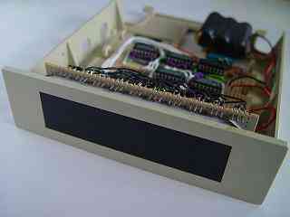

The display is the most difficult part to construct as this is the very visible part and any defects here will show. The LEDs are mounted on 0.1" stripboard spaced 0.4" between centers in both directions. Surplus 5mm LEDs of various colours were used and all are mounted flush to the board, this is by far the easiest way to get all the heights the same. This board has a couple of eye tags soldered to it which are used to bolt the board to the fron two 3.5" drive mount holes.
A piece of grey tinted perspex was cut to be an inteference fit in the 3.5" drive bezel. This goes some way to hiding the board that the LEDs are mounted on but not far enough. To improve the appearance further a backing was made by drawing up a template and printing it onto thin card. This was then cut out and the holes punched with a hand punch. Once it had been test fitted, the holes are a very snug fit round the LEDs, it was painted matte black to make it almost invisible behind the perspex.
The rest of the electronics are mounted on another piece of stripboard that is bolted to other drive mounting holes, the connection between the two is made with flexible wires. Power is supplied to the main board via a disk drive power connector soldered onto the edge of the board.
A rather large NiCad battery, that powers the number generator when the main power is off, is mounted on a double sided sticky pad at the back of the bay. This battery could be much smaller, a coin cell would probably work, but was what was on hand at the time.

A five second, low res, video of the light running is here.
