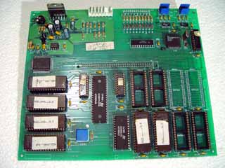

Finding soundsAnother found at a radio rally for not very much money thing. The legend on the card says BWB NEWARK LTD. VSS3 SAMPLED SOUND PROGRAM CARD MK3 but apart from that I have no real info. I grabbed this because I thought the 27C4000 EPROMs would come in handy and there were some other interesting chips on the board. One of the first things I did with the card was to read out the programmable logic devices and the EPROMs.
Four of the EPROMS, labeled MGD_SND_.2_A, B, C and D, are connected to an OKI MSM6376 speech chip and I wanted to know what sounds there were in these EPROMs. While I could find datasheets for similar chips, including chips from the MSM6375 family, they all lacked any information of the format of the stored data, apart from that it is ADPCM encoded.

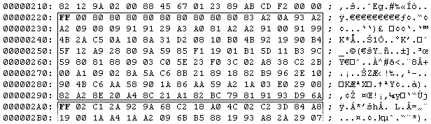

SamplesOnce I found some data on the voice chip I realised that the samples would need further work before they sounded correctly. Using ADPCM decode algorithms made the sounds more coherent but something wasn't right. The sample DC levels would drift leading to positive or negative clipping and there were discontinuities in the output waveform. Looking closer at the data I realised that not all of it was sample sound data.
Samples are made up of blocks, a block consists of a length byte with bit 7 set followed by a number of sample bytes ...
The end of a sample is signified by a null block length byte with bit 7 clear. In the case of the first sample the last block, from address $004020, has a length of $16 bytes and is followed by the zero end marker. The next byte is the start of the second sample's first block.
Without the block length bytes in the data stream the samples began to sound much better but there was still drift in the DC levels and the samples would either clip badly when decoded as eight bit, or would be very quiet when decoded as 16 bit. No ammount of adjusting the decoder gain and offset would cure everything, I even managed to get some samples mostly too quiet with clipping in the loud sections.
