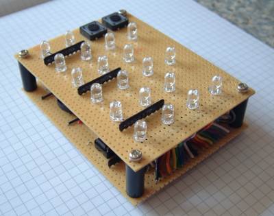

The clock is constructed from two strip boards separated by plastic spacers. A short piece of 20 way ribbon cable and a few additional wires connect the upper and lower boards.

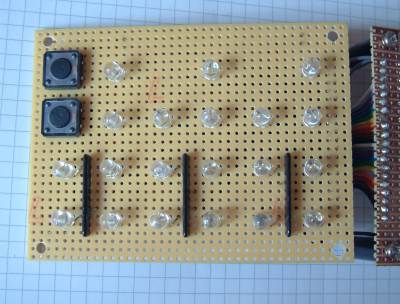

Only the push buttons, resistor networks and LEDs are on the top surface. |

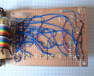

All the wiring on the upper LED board is on the underside. |

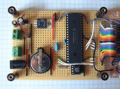

The lower card contains the power socket, +5V regulator, microcontroller and RTC chip. When I built this I was experimenting with solar panels and rechargeable batteries as an alternative to a mains supply which is why this board has an additional diode and two (green) connectors when compared to the schematic.
The brains (and brawn) behind the circuit. |

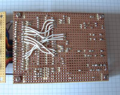

Some of the LED connections are wired on the underside to keep the spaghetti under control. |
