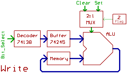

Now an example how to set a Bit:
Let's suppose, that the Bit number is two, or binary 010.
The 74138 generates binary 11111011.
The ALU is configurated to invert this pattern to 00000100,
and then performs a logic OR with a Byte from memory,
which is overwritten by the result.
It's easy.

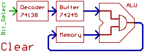

Clearing a Bit also is simple:
If the ALU is set to AND, the Bit in memory is cleared.

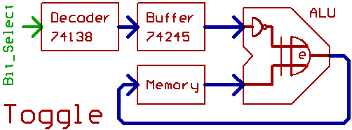

Now to toggle a Bit.
Means, if the selected Bit was 0, its set to 1.
And if the selected Bit was 1, it's set to 0.
The ALU is configurated to XNOR, means the bitmask from
the 74138 is inverted before we do XOR with memory.
Point is, when inventing one input of an XOR gate,
it turns into XNOR.

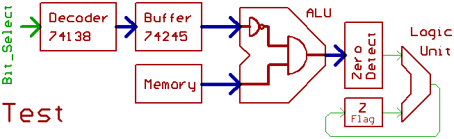

Now that we know how to manipulate a Bit in memory, we take care
about the problem how to get a Bit from memory into a Flag.
One approach would be, connecting a 74151 8:1 multiplexer to the
data bus, to extract the selected Bit and send it into sort of a
Flag/"Register".
But we're trying something more difficult instead:
First we generate the bitmask with the 74138, like binary 11111011 again.
We invert it inside the ALU to 00000100, and then perform a logic AND with
the Byte from memory, so the result would be either 00000000, or 00000100.
We now have to check, if the ALU output is zero, or something different.
Fortunately, we already had built sort of an 8 input NOR gate in our CPU
for all the other arithmetic/logic operations.
It usually woud directly connect to the Zero Flag, but we now place
a Logic Unit (LU) in between.
For the usual set of arithmetic/logic operations, the LU just passes
through the signal from the NOR gate.
But when we test a Bit in memory, this signal would be 1, when the Bit was 0.
Means, if we want to copy a Bit from memory into the Zero Flag, we would
have to configurate the LU to invert the signal.
You sure can imagine, how to read the complement of a Bit.
Always be aware about the polarity of the signal from the
zero detection logic when testing Bits. You also could use a 74688
comparator to test for zero instead of building an 8 input NOR gate.
And since we have a LU in there, we are able to perform any
logic operation there is between Memory and Zero Flag,
like with the MC14500.
Now to take care about how to write the Flag back into memory.
We know how to set and to clear a Bit, so we attach a 2:1 multiplexer
to the ALU, to make it switch between "set" and "clear" mode,
depending on the content of the Flag.
And the rest is simple...
When having a "write complement" instruction, we either need an XOR
to invert the signal from the Flag, or we somehow might exchange the
"SET" and "CLEAR" ALU configuration words before they enter the
2:1 multiplexer.
