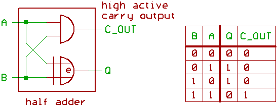

First, we are starting with a simple half adder circuit
from the school books.
It uses a 7408 AND gate, and a 7486 XOR gate.
Q = A + B, and the (high active) carry output
turns to 1, if A = 1 and B = 1.
