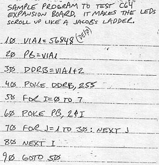

C64 I/O Expansion Board Drawings: Short C64 Test Program
Click the drawing to view it larger.
