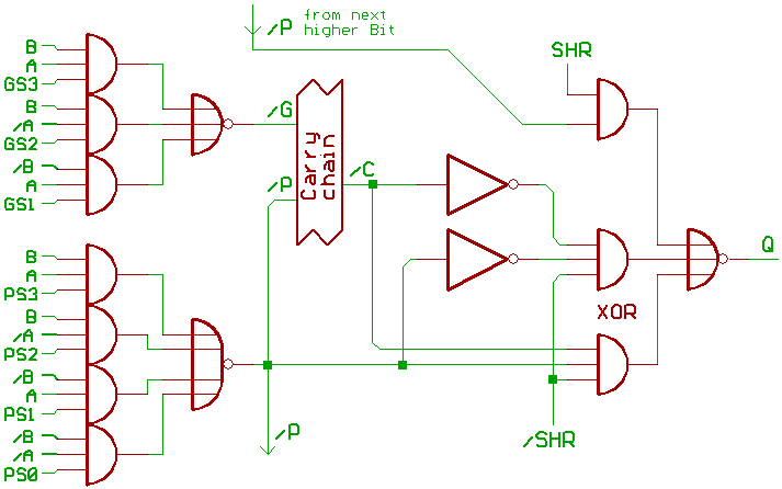

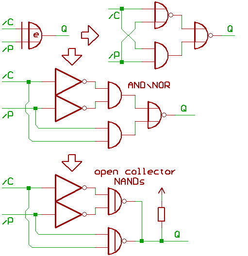

First, we focus at the XOR at the ALU output:
For the AND/XOR_example, an active AND gate (all inputs 1)
will turn the ALU output to 0.
When connecting the outputs of open_collector_NANDs together
to one pullup_resistor, they also work as some sort of
AND/XOR_combination.
Would be nice, if we could integrate the shift_right_multiplexer
into the ALU_output.
Now an example, how to build this ALU with AND/XOR
(Without the unused GS0 gate):

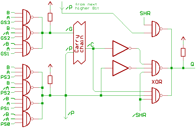

Another example with open_collector_NANDs:
Note the SHR and !SHR control signal at the ALU output.
Looks like we could give the ALU an output_enable,
if we want to.
Yes, 10 open_collector_NANDs and 4 inverters
(two of them in front of the ALU to produce !A, !B).
That's all.
Can't optimize this design any further at gate level.
