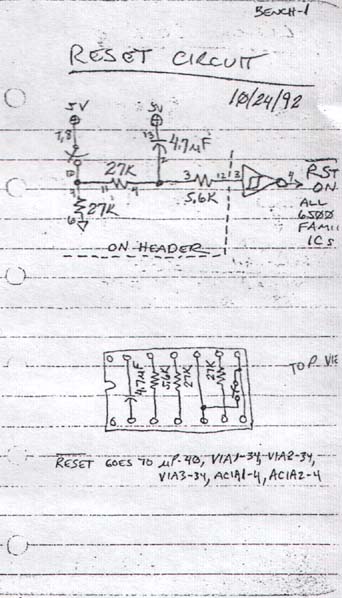

Reset Circuit
Click the drawing to view it larger.
