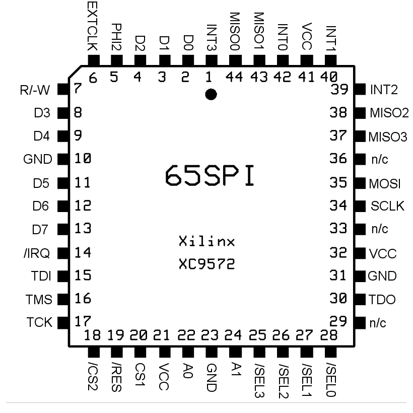

The hardware of the SPI65/B is a Xilinx 9572 CPLD. This device is 5V, so for 3.3V devices level translation is required.
Here is the pin description:
  • PHI2 Microprocessor system clock (input)
  • A0-A1 Microprocessor address bus (input)
  • CS1 Chip select, active high (input)
  • /CS2 Chip select, active low (input)
  • R/-W Microprocessor data read/write line (input)
  • D0-D7 Microprocessor data bus (bidirectional)
  • /IRQ Microprocessor interrupt line, active low (output)
  • /RES Microprocessor reset line, active low (input)
  • EXTCLK External shift clock (optional input)
  • MISO0-3 SPI Master In, Slave Out line (4 inputs, one for each device)
  • MOSI SPI Master Out, Slave In line (output)
  • SCLK SPI Shift Clock output
  • /SEL0-3 Slave Select lines (4 outputs, one for each device)
  • INT0-3 Interrupt input (4 inputs, one for each device)
  • GND System ground
  • VCC System +5vdc
  • n/c No connection
Please note that the CPLD is basically "full". If you need to reassign signals to other pin positions, your mileage may vary. I already had problems placing the signals in a way fitting my netusb2 board.
