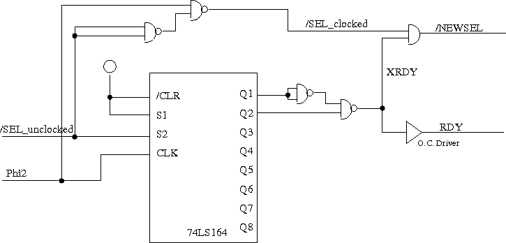

The following diagram shows the schematics
The main IC used for the generation is the shift register 74LS164. It is clocked with the Phi2 clock signal, and shifts the /SEL_unclocked signal through its output signals. With a combination of the output signals the new XRDY signals is created. The timing diagrams below show how it works.

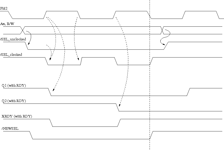

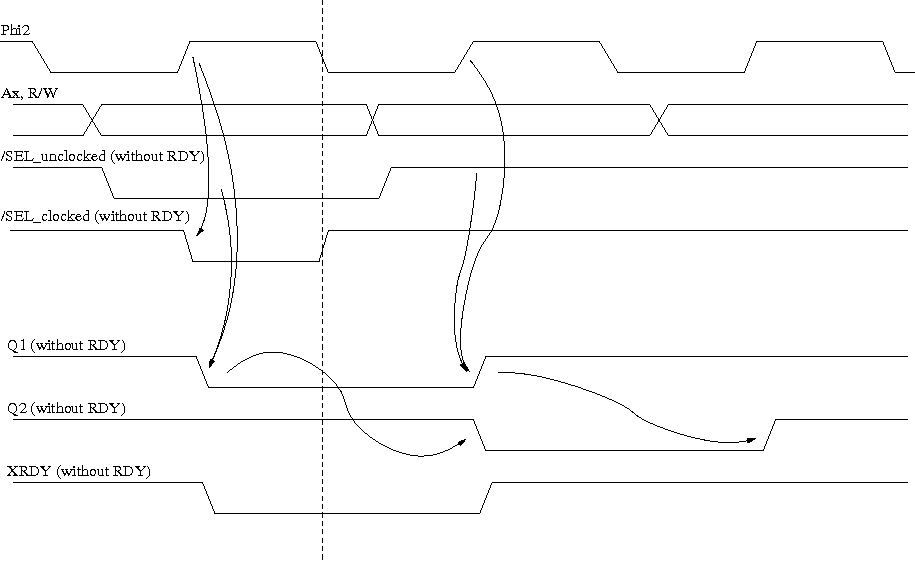

This diagram shows the principle timing, but without RDY being pulled from XRDY.
Phi2 shows the central CPU timing signal. Ax,R/W shows where the address lines and R/-W are stable. /SEL_unclocked is the select signal that is derived from the CPU address lines. /SEL_clocked is this select signal combined with Phi2.
The Q1 and Q2 lines show how the /SEL_unclocked line is clocked through the shift register output lines. The XRDY line is cmbined from Q1 being low and Q2 being high.
The following diagram shows the signals with the RDY line asserted from XRDY.
The /SEL_clocked line now shows two active periods, as it is combined with Phi2 that is going inactive during Phi1. Therefore the /NEWSEL line is generated using the /SEL_clocked and XRDY line.
Note: it is important, that the Phi2 going high signals arrives a the AND-gate before the shift register and Q1/Q2 logic releases XRDY, so that there is no inactive spike on the /NEWSEL line. This is accomplished by the gate delay times.
