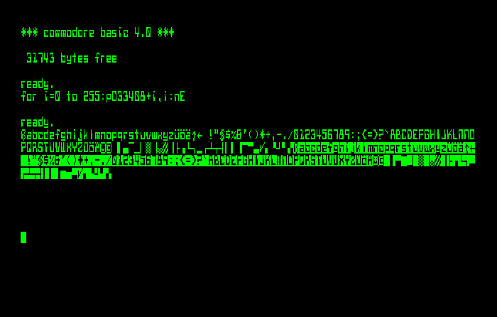

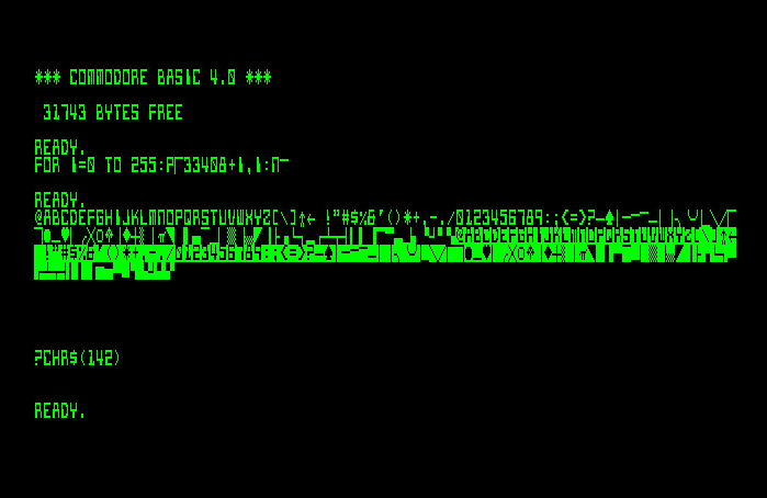

The other surprise was the character generator ROM. The first impression showed that there were at least German umlauts. But when I found the keyboard code trigger I had a good laugh.
Modified Character Set
Once I found the trigger I found what it did: it switched the character set.
As you can see the character set mimics what then was thought of being a "computer readable" character set. Looking at this today makes you smile :-)
Note that there are German umlauts, paragraph and "sharp s" (ß ), although in non-standard places, at least compared to the standard German (CBM 8296) character generator ROM.
Please also note the "smiley" and the "copyright" symbols!
This change also is in the "standard" upper/lower case character generator:
How the trigger works
The trigger uses a lesser-known feature of the PET video graphics system. The CRTC chip has 14 address lines, capable of addressing 16k of video RAM. Only 4k are used in the PET. So the upper lines can be used for other purposes. The 8032 models actually use video address lines 12 and 13. TA12 is used to invert the video output - unfortunately _after_ it has been blanked for the retrace, which means you cannot use it to quickly invert the screen for effects.
TA13 actually is connected to the /CS2 chips select signal of the character ROM. This line is active low, so if the CRTC address is set in the lower half, that's fine and this is done in the editor ROM. If you would program this line high, the ROM chip would not be selected, and no output would occur.
Now if you look closer, you can see that the ROM chip is labeled as "2316 or 2332". Which means you can use either a 2k or a 4k ROM. If we do the math we find that a character set visible at any one time has 128*8=1024 byte, i.e. 1k. Adding the graphics vs. lower/upper case mode results in a normal character set ROM being 2k. And the ROM chips has 11 address bits, A0-A10, which can address 2k, which fits this.
But how does the 4k ROM fit in here? There is no address line for it, but it still works! If you look at the 2316 and 2332 datasheets, you may notice that the 2332 has one select line less than the 2316, to make way for an additional address line A11. And, by chance(? ;-) this is /CS2, which is connected to TA13 in the PET.
This means that if you use a 4k character ROM, you can switch between the two 2k character sets by programming the video RAM address in the CRTC appropriately. And this is exactly what the trigger code in the editor ROM shown above does. By pressing left-shift, "3", "x", and "/" at the same time, you can toggle between the normal and the "computer" character set.
