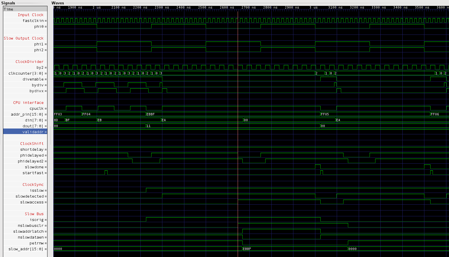

Once slowdetected is asserted, the CPU clock is held high to await the actual slow cycle. I.e. I don't use the CPU's RDY pin, but the 65816 feature that it can be stopped indefinitely with PHI2 high.
As the fast and slow clocks are not synchronized, the detection that a slow access should be done can be anywhere during the slow clock cycle. It could be during PHI1, PHI2 close to any of the transitions, anywhere. That's where the "arbiter" kicks in.
General timing structure
In this diagram you can see that the first slow access is detected at 2300 ns, in the middle of a slow cycle (PHI0/PHI2 high). The actual slow access thus has to wait for the next slow PHI1 cycle to actually start.
In the timing diagram you also see a signal called phidelayed. This plays a key role in the synchronization mechanism. This signal is the slow PHI0 input, but delayed for a certain amount of time (and OR'd with PHI0, see 2 MHz operation below). The falling edge is important here. phidelayed is delayed such that the falling edge is far enough before the rising edge of PHI2 to allow for address bus setup times. Therefore when phidelayed goes low, and a slow cycle is already detected, an actual slow cycle starts.
More concrete, when slowdetected is detected on a falling edge of phidelayed, then slowaccess is asserted to actually start a slow cycle. To avoid any race condition (such as one signal derived from slowdetected having a different propagation delay than another and then only one of these being latched at phidelayed going low), this signal is then used as "single point of thruth" signal to enable the slow bus (only if the slow access actually goes to the slow bus, and not to the board's RAM or ROM). These signals are then latched with phidelayed2 going low which comes 20 ns after phidelayed. The nslowbusclr, slowaddrlatch, nslowdataen and rnw then determine the state of the slow bus (details see below).
After the slow access, when PHI2 goes low, a small pulse signal startfast is generated to then restart the fast access. This pulse actually enables the fast clock counter again (divenable) so that the fast clock starts with a fresh, PHI1 cycle (i.e. PHI2 low). In the diagram you can actually see that the next cycle is also detected as a slow cycle, but it is not detected as going to the original system bus.

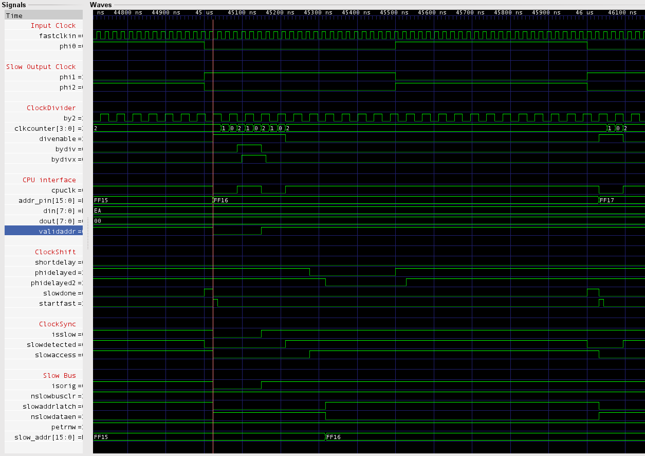

but when the cpu access is not valid, there is no need to wait for the actual slow cycle. instead the cpu can continue with the fast cycle and then begin a new cycle. this new cycle is then (most of the times) a valid one. So when the complete invalid cycle plus the phi1 phase of the following valid cycle fit between phi2 going low and phidelayed going low, the slow system only sees two consecutive - valid - cycles, and the invalid cycle is hidden!
You can actually see an invalid cycle being hidden in the diagram linked here. The CPLD builds the validaddr signal from VDA and VPA. When this signal goes low, the cycle is not valid, which happens shortly after time 45us in the diagram, where the red marker line is.

To hide bogus cycles, the time interval between PHI2 going low and phidelayed going low must be long enough. Unfortunately, when the system is running at 2 MHz, this time interval is too long: there is not enough time between phidelayed going low (starting a slow access) to allow for the address setup times on the slow bus. In fact the falling edge of the phidelayed actually runs into the following PHI2 phase! That is actually why phidelayed is OR'd with PHI2, so that in this case the system does not hang.
That is where the FASTMODE clock register bits comes in. It is set by default and reduces the phidelayed delay such that the system actually works with 2 MHz. But there is a cost - you cannot hide bogus cycles anymore.

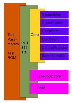

in this section i will describe the main structure of the vhdl code that implements the logic in the cpld. i will also go into ways of efficient testing as i experienced while developing the board.
vhdl structure
vhdl defines that logic is separated into modules. each module has input and output signals that define the "interface" of the module. in general you can think of these modules as being similar to logic ics. these ics resp. modules are then plugged together in higher level modules, using the input and output signals.
so i have separated the cpld logic into different modules as well, which i am going to explain here. the different modules and their structure is shown in the side image.
pet816.vhd
this module is the top level module. its input and output lines are the ones that are used on the cpld pins. it does not actually contain any logic. instead it only passes the signals to the core module. in addition to that it also defines the power-up values of the clock and control registers, that are passed to the core module.
the power-up values for the registers are defined in this module, so that in a debug setting i can define different power-up values for the registers without changing the core module.
core.vhd
the core module is the one that holds all the other parts together. its input and output signals are the ones for the cpld pins, but additionally contains the power-up values for the clock and control registers.
internally it wires all the other modules together. mostly it does this by wiring signals from one module to the other. only a few signals are created in the module itself.

To be able to test effectively and efficiently you need to take some care and create a good setup. The picture on the right shows my test setup. As you can see the Core and its contained modules are exactly the same as in the CPLD setup above. The PET816 module is left out though, but that gives the opportunity to pass different, test-related power-up values to the registers.
The main test setup module is the PET816 Test Bench (TB) module. It simulates the actual system, i.e. it wires together the actual CPLD Core module with a 6502 CPU, some RAM and the external test parameter module. In the test bench the hardware of the 65816 board is simulated in a basic way. For example the '273 address latches are emulated to simulate the correct system bus address values (and therefore to read the correct data values e.g. from ROM). The test bench also contains the clock generators for the internal (50MHz) or system bus clock (1MHz or 2MHz depending on config option).
The outermost module is the actual test. It contains the test parameters and the test ROMs and feeds these values into the actual test bench. Test parameters are the initial register values for example. The ROM has a RESET vector, and contains NOP operations as default value. Only the code that is needed for the test is put into the emulated ROM. This way the only module that is specific to a certain test case is the outermost module and is actually implemented as a separate file for each test case.
