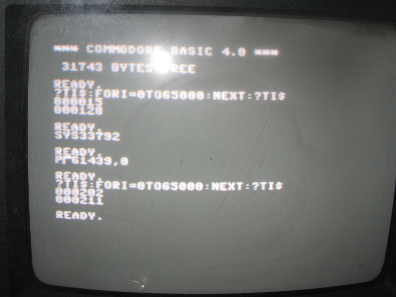

Screenshot of a timing measurement. On the top of the screen you see the result of the original speed, then copying (SYS33792 where I assembled the test to), then POKEing the control register to fast speed and measuring again.
And even as I am getting used to soldering SMDs, I still think of it as a feature, that except 1MByte of RAM the board is in classic through-hole technique, and can be run without SMD parts.
With this board I was able to achieve a speed increase of over 8 times compared to the 1MHz system :-)

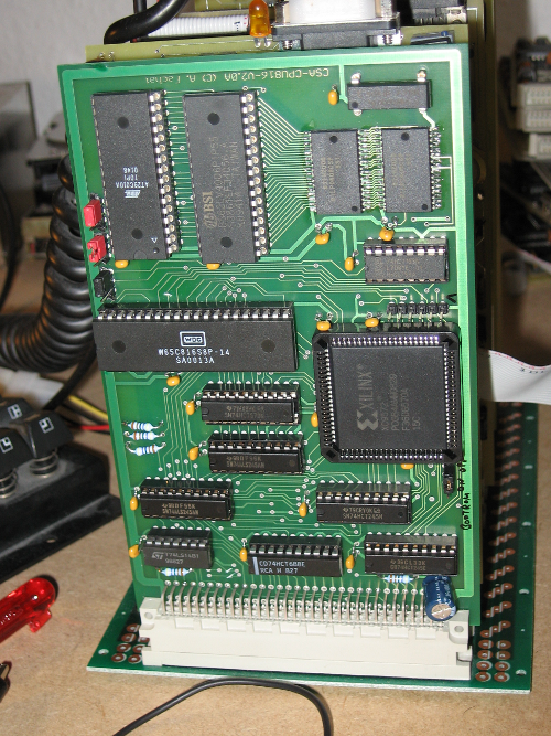

The 65816 CPU board version 2 with the PLCC CPLD logic chip.
Now that the version 1 board was working, I decided to use this as a starting point and simply recreate the same schematics basically in the CPLD. As a programming language I decided not to use the schematics, but go for VHDL.
This resulted in the CPLD programming environment giving some warnings about latches it detected, as well as combinatorial feedback loops. But yes, that's how the version 1 works, using well-placed and controlled flip-flops, and also feedback loops. So I ignored the warnings.

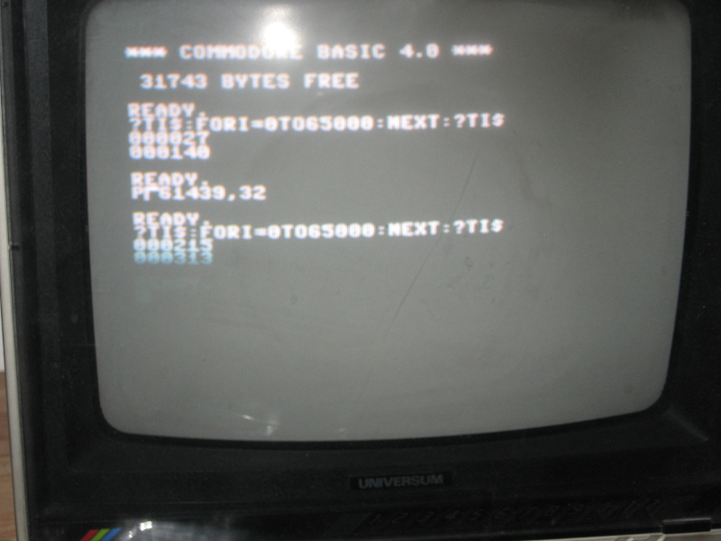

Remove bogus accesses: Screenshot of a timing measurement. On the top of the screen you see the result of the original speed, then POKEing to ignore bogus CPU accesses and measuring again. See about 14% speed increase.
