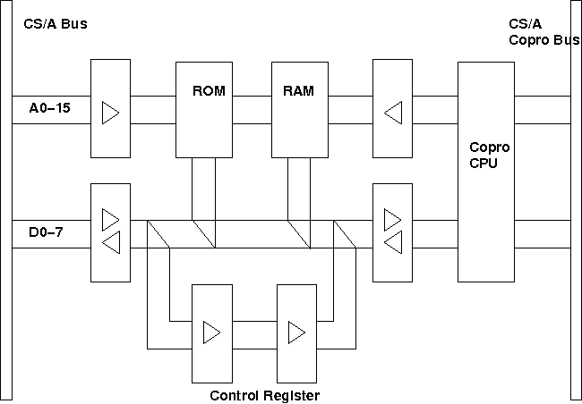

CS/A65 Copro
This board implements a 6502 coprocessor board for the CS/A65 bus system. The coprocessor runs in parallel to the main bus CPU, with the same clock frequency as the bus itself. The bus CPU and the coprocessor can communicate via a 64k shared memory area on the bus, as well as via a shared control port. The port is protected against concurrent accesses from the two cpus by optimistic locking (explained below). The coprocessor board has a separate bus socket where another CS/A65 I/O board can be plugged in that the coprocessor can handle independently from the bus I/O.

This test suite contains four tests that each use the coprocessor in a different way. The first test simply sets the shared memory to new values, the other tests use an I/O board (here a DRVIO board) to toggle I/O lines (here the two LED lines of the DRVIO board). These tests test the I/O and the interrupt abilities.

block diagram
Block diagram of the coprocessor board. The coprocessor and the CS/A bus CPU access the shared memory and I/O register using time sharing: during Phi2 the bus CPU has access, and during Phi1 the coprocessor has access.
