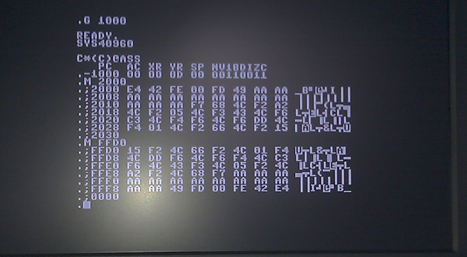

Simple test suite
These tests implement some basic test cases:
If you look close enough you can see that the memory from $f000 is copied to $2000 - but in the reverse order :-)

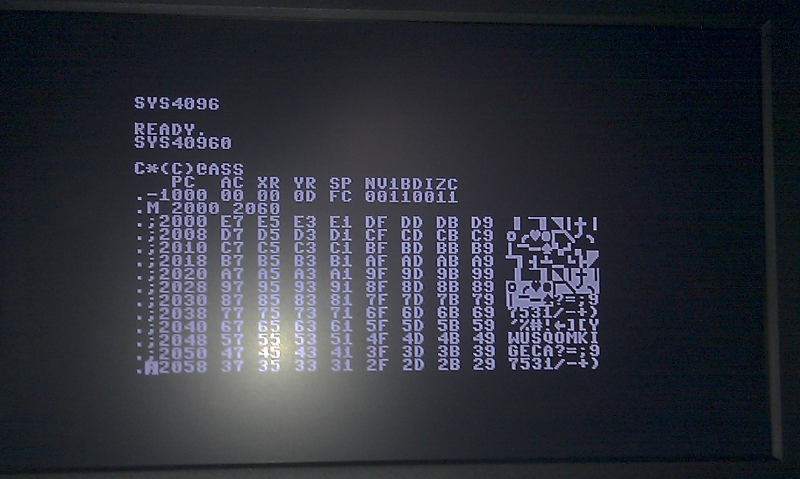

Result of blitter4 test - you can see the timer counts 2 cycles from one access to the next :-)

  • blitter4.a65: sets up a VIA timer, and copies timer values from the timer to memory at $2000 (512 byte only)
