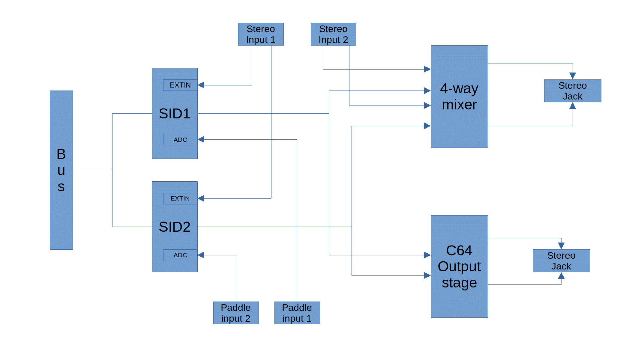

block diagram
This diagram shows an overview on the board, with the two SIDs, the mixer and the output stages. Connectors for the SID EXTIN and Paddle (ADC) inputs are provided as well. Note, that not all SID replacements support EXTIN, so an external mixer is included.
